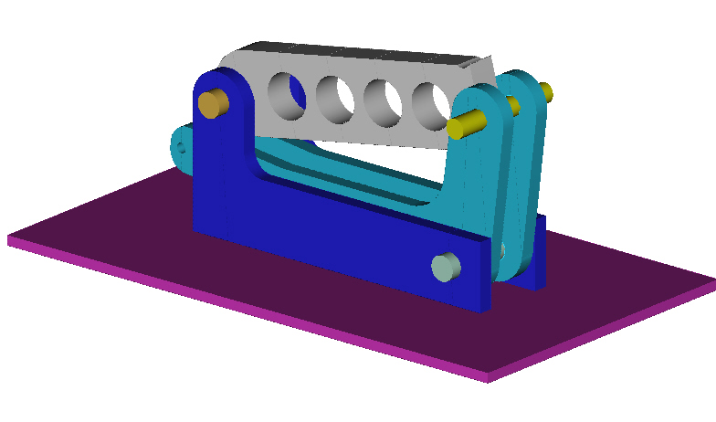

Anyone interested in a quick-release system like this? You must attach the flat plate to the hull somehow. The strap is captive under the plate with the holes. Release is done by pulling up on the long end of the teal lever.
I've still got to do some minor tweaks, like a spring to hold the lever in the "secure" position when the boat is upside down.
Weight will be about 14oz. Might go lower if I find that it's overdesigned when I make the prototype.
Cost will be in the $50 range (no profit for me).
