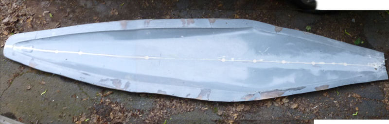

I'm finally (after two years!) getting close to completing the mold for my new slalom C1. Considering that it's just a modification to my old slalom C1 design, I don't have a good excuse for my tardiness. My first approach was to modify my original plug, but that turned out a bit of a mess, so I am modifying my mold instead. Basically splitting it down the middle, widening the bow and narrowing the stern. Final length will be 3.65m (totally arbitrary).
Early picture of the split hull:
http://www.wwslalom.net/bob/csx/hull.jpg" onclick="window.open(this.href);return false;
I'm using steel angle to hold the flanges at their original angle while I mate the two halves together.
The deck mold, only needing to have the wings filled in and a final sand:
http://www.wwslalom.net/bob/csx/deck.jpg" onclick="window.open(this.href);return false;
I'd prefer to have Kaz do the layup, but the mold is extremely heavy and somewhat fragile, so I'm going to lay up myself a "cruising" prototype from which I can take the final mold. I'm planning on taking some time off in July, so I should be able to demo the boat then. I'll probably hit DC, NOC and points in between.

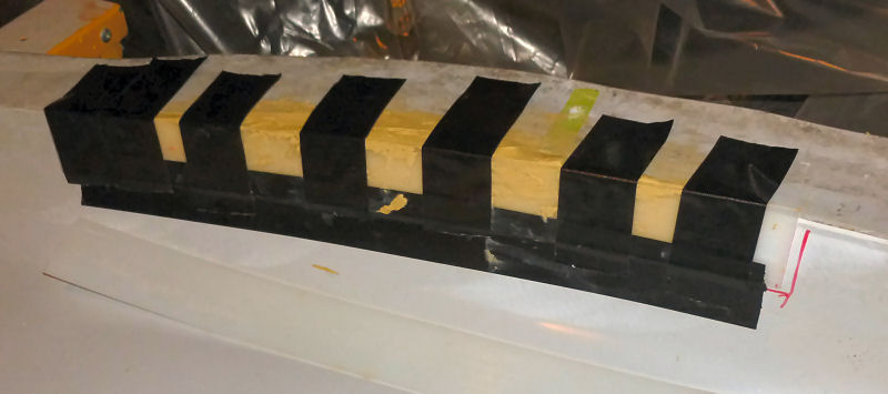

And then it was wing-less.
I used some hard plastic strips to corral the Bondo very close to a smooth final contour.
http://www.wwslalom.net/bob/csx/plastic.jpg" onclick="window.open(this.href);return false;
It looks like this when the plastic is removed:
http://www.wwslalom.net/bob/csx/rside.jpg" onclick="window.open(this.href);return false;
Fortunately I've got an orbital sander to do the basic shaping. I had to add a bit more filler in a couple of places, but it shouldn't be more than an hour's work to finish. It's right at 65cm wide now, so I may add a bit of width just in case it shrinks when it comes out of the mold.
There are some matching holes in the hull and deck molds, so I can transfer the new contour to the deck with a template.
