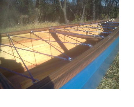

I know, people will throw rocks at me. However, I used Doug-fir to replace some gunnels on an old boat because it was easy to find and really cheap. I wasn't expecting it to last, but it did just fine for 3 years. The gunnel will wear a bit faster, but Doug Fir is pretty tough for a softwood. I recommend making the out-wall just a tad thicker than normal. Its also VERY easy to bend and shape. I now use it to replace all the gunnels on my wood gunnel boats when they need it, and I put some on my prototype boat. Total cost for the wood the last time I did it? $7.50. So what if they only last two or three seasons? Its cheap and easy, and they look just fine.

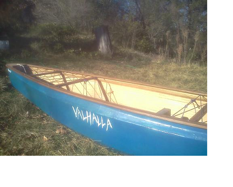

Some photos of my seven dolla'fitty'cent gunnels

Just now actually read your name, care to expound?

'Valhalla Long Boats' is the name of the company I'm starting. That particular boat is called 'beowulf' (before any lit majors bother to tell me, I am aware Beowulf is not actually a figure in Norse mythology). I am hoping to get Bill Cross to paddle it and write the on-water review for it this spring. He wants to paddle it, I assume it will cost me beer to get him to write the review. I'm also hoping to build a mold from the prototype this spring, and then I'll be selling them...assuming anyone still wants high-performance canoes in the 13 foot range...perhaps a large leap of faith. I am in the middle of designing an 11-foot version of the boat that will either be called Loki...or perhaps Achilles (again, Lit Majors need not pester me about this).
