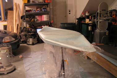

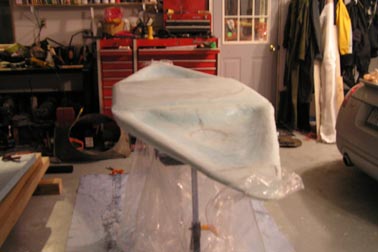

After a lot of shaping, measuring, and more shaping, the rough plug is done (foam is shaped, and glass / epoxied over it).
This weekend my mentor has offered to spray it with gelcoat or duratec so i can start the long, long, long sanding process. The curves that looks so great on the deck will be a royal pain, I know, but I've been able to get A LOT of volume out of the boat, and it makes the deck much stronger (the hull will need reinforcement when built due to the BIG FLAT planing area.
So, it's still moving along....
From the Bow
From the Stern
For the curious, the saran wrap is to keep the glass on the ends 'stuck" overnight. It'll mean a bit more grinding to get all the wrinkles flat, but it's the best I could come up with for the night. I'll be grinding outside, and wearing a respirator....

I thought this was going to be a big guy's boat? It's looking as scary as an Oxygen :o I can't believe that you did the pools so quickly & that they look that good. You da man 8) Not much need for walls is there :lol:
Posts: 4136
Post by Sir Adam »
HA! I'm not sure I've ever seen 'big guys boat' and "Squirt boat" in the same sentence...except perhaps in in reviews of the Atom :wink:
This boat has a lot of other ideas from other boats in it, the Oxygen among them. Realistically, the four boats out there that have the capability for downtime are the Oxygen, Acrobat, Meltdown, and Maven. Depending on your comfort with unstable boat (trying to be polite here) the Oxgyen and Maven may or may not be options.
I'm hopeful this boat will combine a lot of the "good" features for downtime with the "new school" features for other river play (planing hull), and comfort (WIDE boat, rocker, cockpit rim made by a C1 paddler for C1 paddlers to really let your knees get OUT to the sides of the boat. This idea is brilliant and necessary and solely atributed to the Sith...the folks at Shaggy really have something there.
The "pools" bow and stern will be interesting 8)
I'll post more images as the process progresses...feel free to post any thoughts and comments along with way :D
