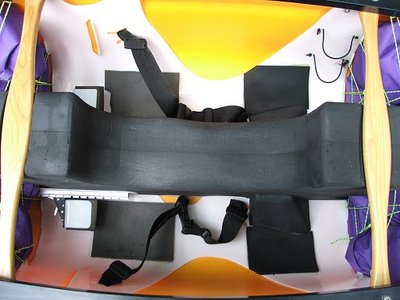

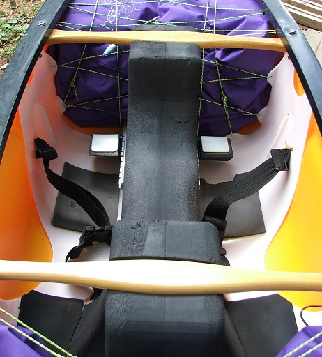

I completely disagree...
That being said... thank Scott Broam
https://plus.google.com/photos/10386890 ... 4394807026" onclick="window.open(this.href);return false;
https://plus.google.com/photos/10386890 ... 9413816770" onclick="window.open(this.href);return false;
https://plus.google.com/photos/10386890 ... 8183233266" onclick="window.open(this.href);return false;
https://plus.google.com/photos/10386890 ... 0388816290" onclick="window.open(this.href);return false;
you could always go the Dagger Quake/Aftershock/Atom/Cascade plate route if you can find one... maybe he who's name shall not be uttered has one.
Esquif has my plans and specs for a factory plate/saddle set-up... not sure of the status of the project though... having something ready made as an option to buy for those that prefer straps... and for demo boats, schools, fleets etc. made a lot of sense to me. what people would be willing to pay for it though ???
if you make a plate though be sure to glue it down with a 1/2" thick layer of minicell between the plate and hull... otherwise little grains of sand and gravel get trapped under it... plus it adds rigidity.
