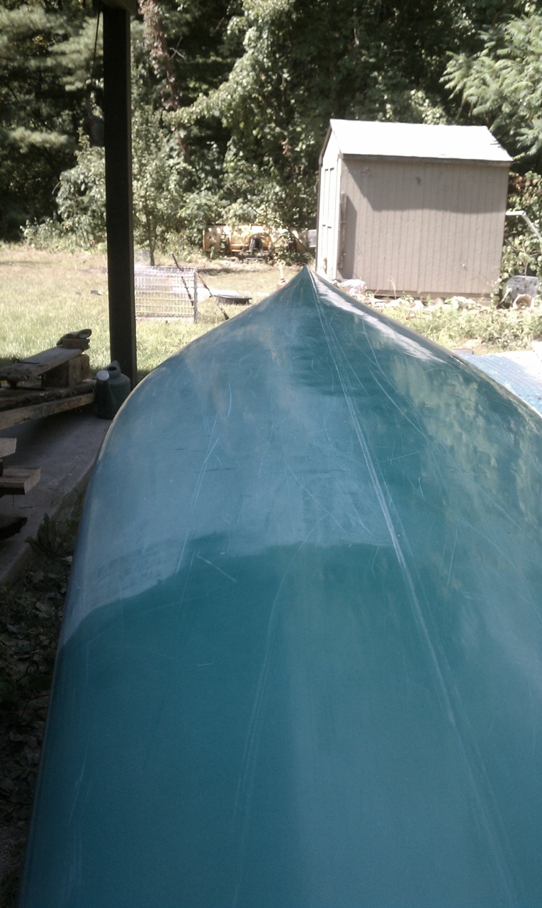

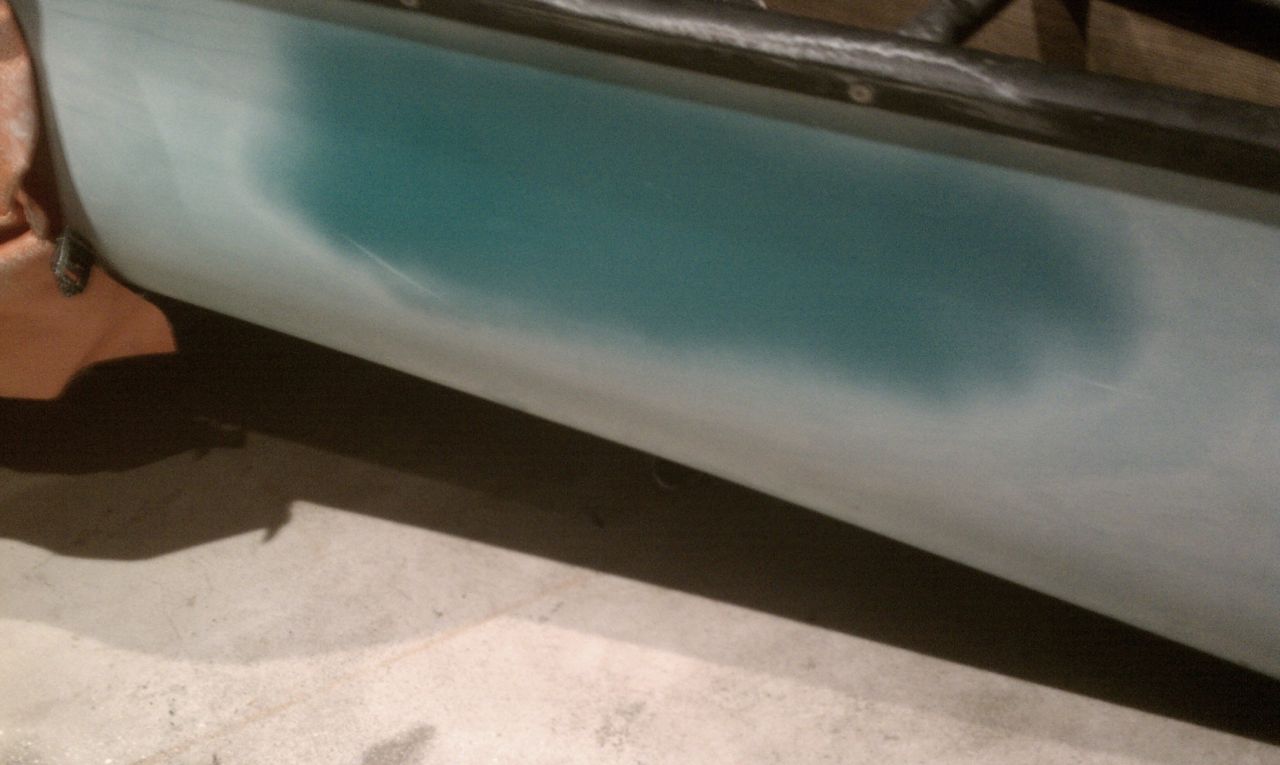

With the number of used boats I've picked up I have several that although sound look rather shabby with a lot of the gel coat oxidized. I finally got around to trying the 3M Marine Restorer polish and wax (made for power boat gel coats). A few minutes with a buffing wheel on a drill seems to have made a big difference.... This is on a Wenonah Advantage. I have yet to try it on any of my whitewater boats, but if this goes well I just might.

It works well... here's an update.
I'll likely go over the sides again though as I got a bit ahead of myself and didn't polish as much as I should have before waxing. Below waterline looks good though!

$20 or so for the 3M polish / wax (1 step process, but apply and buff), and turning a buffing pad a rather amusing shade of blue / green.
The buffing pad I used attaches to a drill - in a perfect world I'd use one on buffing machine / angle grinder sort of thing. Might be getting one soon for another project anyway. BUT, as a cheap way to get it shined up (under $30 total I think) not too bad.
Time wise about 2 hours I think, but I didn't do it all in one stretch. and the Advantage isn't exactly a small boat.

That looks great! I must might have to try that on my slide next spring.
