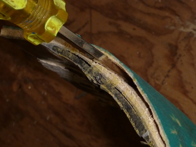

As for removing the vinyl layer or not, I have always sanded the vinyl very well and cleaned it with denatured alcohol but have not generally tried to remove all of the vinyl. In all cases the vinyl was partially gone in the area of the repair. Ezwater, who posts here quite a bit maintains it is best to remove the vinyl with a wood chisel to allow bonding directly to the ABS to prevent the potential for the vinyl to delaminate from the underlying ABS taking the repair with it. I do think that makes sense from a theoretical standpoint, but I have not usually done it and haven't had problems so it is up to you. If the vinyl comes up fairly easily without a lot of gouging of the ABS I would say do it but if it doesn't and you don't want to take the time and effort to sand or grind it off, don't sweat it.

This is a shot of how a low angle chisel will lift the vinyl off the ABS. It takes advantage of the fact that the vinyl is soft, while the ABS is relatively hard. The chisel should be held at a low angle, and perhaps at a small angle relative to the direction of skimming.
On what cloth to use, I would still favor S-glass over polyester, because S-glass will result in a very resistant repair to compression forces. But I would be very interested in reports on performance of polyester.
