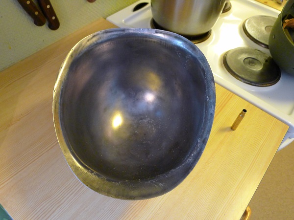

I am now in my last year at university and I feel that I should utilize our composite lab for some fun before I finish my master. Last year I did all the fibreglass work on my Stinkeye canoe in the lab to the amusement of the professors. This year we have gotten quite a bit Carbon fiber prepreg…. It is exactly the same stuff they make F-35 parts out of. (High modulus stuff, not some cheap consumer carbon fiber). I have been thinking of making something paddling related, not just fancy dining plates as others do. My idea goes towards a helmet for park and play use.
I have seen look alike German WWII helmets in carbon, but has anyone done a US M1 helmet in carbon before? Is the shape be good for WW paddling, or is it a bad idea? I think a M1 helmet is more accepted than a German helmet here in Norway.
My idea is to use an original M1 helmet as the mould. Just polish the inside and mould towards the inside of the helmet. The prepreg needs 170 Celsius/338 Fahrenheit to cure so I will need some kind of metal mould anyway. Good idea?

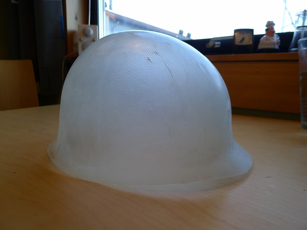

Short update: The realeas angle on the helmet showed up to be to small so it was terrible to remove the test helmet I made.

...and a solution for your mold concern - two part mold (bolted and unbolted). You'll need to have a good tight seam, perhaps use a bit of clay (or not), and may need to do a little clean up after you pull the piece, but you'd be able to release it then....
Re: Carbon M1 helmet
Back when bullet head type helmets were the rage for racing, I made a 1 piece mold, and the first few helmets were quite a fight to release. I drilled a small hole (where one of the strap anchors would go) and used compressed air to release the new part. I will note that I ALWAYS used PVA just to give me an extra margin of error on release.
