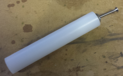

I sell all my saddles with a 6" long, 1" diameter plastic dowel for attaching the saddle to the thwarts. I also sell these dowels individually, with a stainless screw and cup washer for $7 each. I have used hardwood dowels in the past and they all end up rotting, even taking great care and sealing them up well. The problem is that the hole you cut in the saddle holds water and it doesn't fully dry out. This means the wood dowel is constantly in a moist environment, and it will eventually deteriorate, unless you are frequently re-sealing it.

Todhunter do you glue the plastic dowel or just drill a hole in the foam and insert?

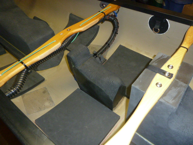

I've had thwarts break from bottom pressure being transferred up thru the seat. (hitting a rock) Both wooden and metal tube have broken.
My Occoee (2nd owner) has a very definite wear pattern on the hull, right in front of the seat base glue down. The effect is not just vinyl wear, there is a definite visible "bump" in the hull.
My thoughts vary on this; if it's a 2nd hand purchase I just paddle it as is but on my next seat installation I might carry the design of the seat so that it extends further forward up to the airbags providing a more flexible and gradual transition point instead of 205 lbs on a "sharp" minifoam edge.
I have used a dowel rod thwart to mini cell system but usually leave a space/gap tween the thwart and mini cell
and just rely on the dowel to reduce side to side flex in the seat.

Elgotto, I just leave the dowels unglued, or "floating". If you glue it, it will tear loose every time.

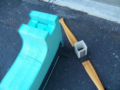

I wanted the midst surface area possible, so I used vinyl downspout (about 2"square) on one boat. To fit it in, I used a steak knife to incise the square so the vinyl fit snug and I removed little/no material. I ran the cuts deep so it could travel some. I attached it to the thwart with metal L brackets. It's worked well.
