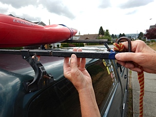

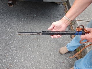

I have no problems with canopy side mounted gutters, although I made sure they were located over a side wall pillar to transfer the load directly to the truck bed. The rail to rail spread is a little wide for the newer short canoes and play kayaks, at the moment they go in the back. I'm thinking of adding a third rail between to secure the short hulls, maybe with a vertical fold up "wing" for side stacking.
I scavenged a pair of tall towers for the front and also added 2x2's on top of the front rail so the Captions and the Occoees don't rub on the cab roof, as Ohio has commented.
I had a machine shop make up at set of Extenders that slide into the ends of all four rails that gives me an additional width per rail of 16" total, just legal. There is also a tie loop on the end of each extender, handy for monster loads on shuttles; wrap the bundle.
Since the load on the Extenders is fore and aft I secure them in with rope tied to the towers.
The extenders are slim enough to store under the back seat in a bag.
e Truck is a GMC 1500 Sierra with a 6'6" bed.
