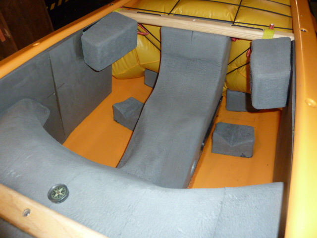

I use a different approach that I call "shin blocks". It distributes the weight across a much larger area, provides much better circulation, and takes most of the weight off of the knees. I personally can't do ankle blocks. They cut off circulation to my feet and I'm out of the boat every 10 minutes with pins and needles. My shin blocks actually stop a few inches above the ankle.
Here's a couple pics of my old Detonator for an example...

McPherson, That's an interesting take that I haven't seen before & may help. Turns out that I have a torn medial meniscus & MOST of the pain was being caused by that one specific injury. Hopefully, if & when I get the cartilage tear taken care of...most of my pain & problems will go away. In the interim any boat fit advice & input on dealing with knee pain will be greatly appreciated. 35 Years of paddling, hockey & skiing and No knee pain...until I hit the Big 50. This has been a big adjustment & I have been learning a lot. Peace...
