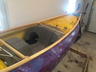

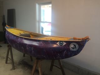

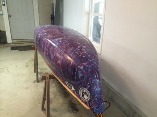

Lets see if I can do these pictures correctly. Just put it together over the weekend. I have not had it out yet ... under 35 lbs

Sweet looking boat! Nice job on the outfitting too :D
Hope you enjoy it!
Posts: 4136
Re: Blink impressions
Post by Sir Adam »
That is a sweet looking Blink!
Wendy
Paddling Benefactor
Posts: 913
Joined: Wed Apr 27, 2005 3:02 am
Location: North Carolina
Post by Wendy »
Very sweet colors and bulkhead.

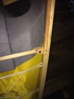

That looks nice Craig. Can you snap a pic of that thwart to gunwale detail and post it here?

I cut a elongated D shaped piece of 1/2" thick ash. I actually flared it out a bit like the greek letter omega. Then bolted that under the gunnel, flat side against the hull. I used 2 small screws that I countersunk, with stop nuts for each "D" Then I bolted the thwarts to the "D" bracket with a larger screw/finishing washer/stop nut. I could probably done it with a metal angle bracket but I was a bit concerned about any sharp edges if it came loose

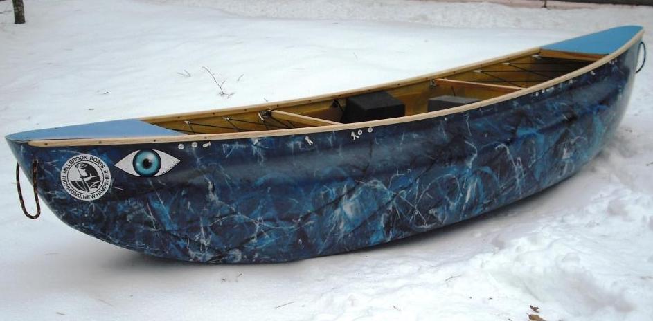

And another one.
