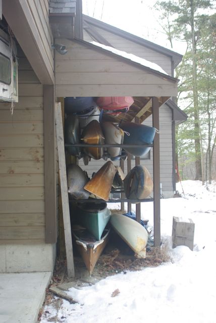

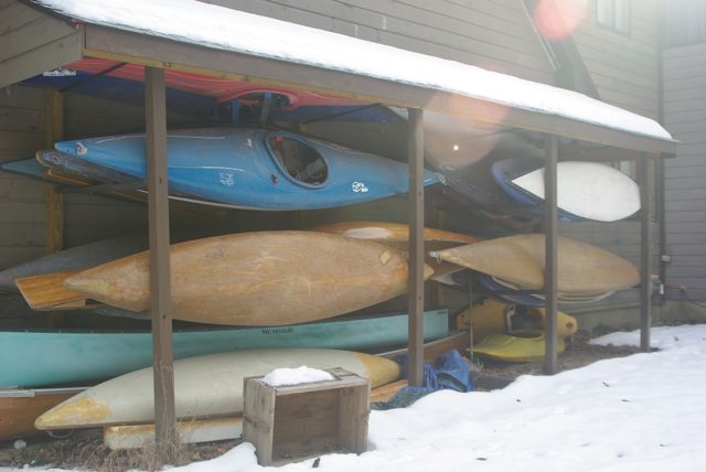

I've finally gotten around to taking a few images of my "small" boat rack. Yes, AdkSara is very understanding. And no, this isn't all of them.
On the NW side of the house, so sun never hits them I've thought of setting up a tarp 'curtain' to keep any reflected sun off, but have yet to do so. They are out of direct sunlight, do not get rained or snowed upon, and are dry. Verticals are 4x4 treated lumber - I made 4 "squares", then tied them together across the top, bolted them to the house, and then made deck supports, put plywood up there, and shingles to match the house (and roof angle matches one of our other roof pitches.) Cross pieces are 1/2" iron pipe with foam insulation around them. If I wasn't trying to fit as many in as I could I would have used 2x4's with carpet on top (attached on the sides).
