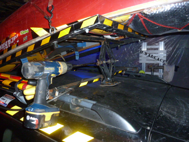

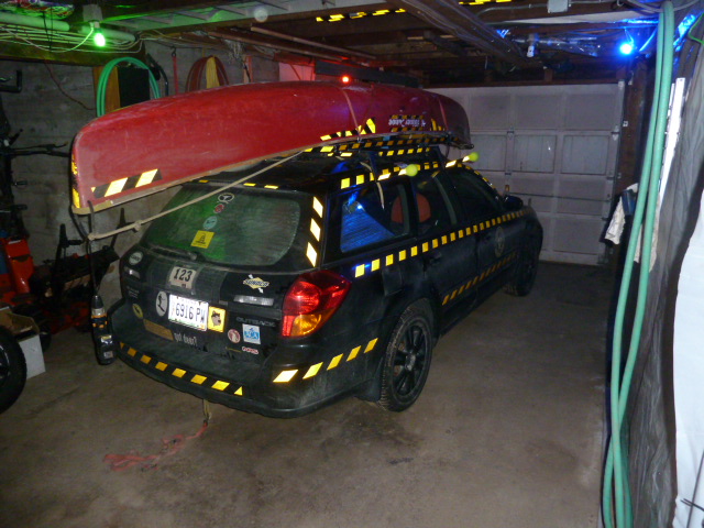

Here are some photos of my Subaru Rack.
I always hated having to load boats at the last minute because they block access to the trunk or rear hatch. Having fabricated several racks for various cars I began to brainstorm a bit for a solution to this problem and this is what I came up with.
https://www.dropbox.com/sh/38d4g7ibne6pheu/6eT7hrBhrW
It pivots forward to allow the rear hatch to open the whole way and to facilitate gear loading underneath boats.
The front of the rack pivots on two 3/4" pillow blocks (basicly bearing holders). I fabricated the main frame out of 14ga 1" sq tubing. I used 1 1/4" Sq Tubing to make bar extenders (not shown in these photos) as well as for where the rear portion of the upper rack mates to the lower rack.
This was a fairly involved project and took an entire weekend plus a week of evenings to complete. If anyone has any questions feel free to ask.

soobies rule the paddling world! my tilt-o-rack system.

I have seen the Subaru rack. It is quite impressive!
