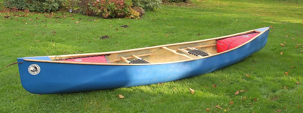

let me introduce me - I am the "he" and the "buy from across the pond"
Just want to get some things sorted out: My fussy comments about my boat were regarding some humps of resin, of which most I did already remove with a cutter. The other things are some dodgy looking marks at the stern. Do I have to like that on a new boat? Not sure.
As Mr. ezwater posted my first impressions, which I sent him on SOTP in reply of asking him about the ACDC (as he seemed to know this boat), I want to say that my expectations regarding actually paddling this boat were exceeded by far. Sure, going solo on flat water it is no rocket, but still pretty fast and responsive.
And another point is - if you buy a Millbrook canoe, you actually get pretty much boat for the buck. Despite of my gripes regarding the stated issues, I am a happy paddler in my boat and it is very likely that my solo-boat to come will be another one from John - if he will make me one, still

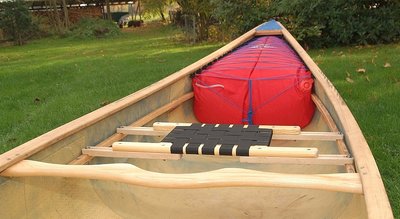

sbroam wrote:Gerrit - thanks for the pictures! I'm curious about how the seats are installed. Did you do that or did Kaz install those that way? How heavy is it?
You're welcome - glad that someone asks about the seat installation, as I have spent so much time on it
I glued some Aluminium angles to the hull, made 4 stripes of beautiful ash, bent them and mounted them to the angles. The aim was to make the seats adjustable for different loads / persons and for going solo.
You got me, though - this solution is a bit on the heavy side. Seat installation is (John, don't read, no, dooohh!!!) 5kg Without the seats and their supports, but including the airbags weight is 22kg. Guess I will laminate the supports (make tubes from kevlar) and make some leightweight seats. Or make pedestals from minicell. Or... Anyway, the weight is the reason why the seats look somewhat unfinished.
My solo paddling is from a kneeling thwart in this boat.
My question about the weight was about the overall weight of the boat, but I didn't make that clear. I see how you had to accommodate the changing width and why your seats are heavier. Interesting solution, though.

The ACDC is already vacuum bagged, John claims 45lbs on his website. We opted for additional layers of S-Glass and Kevlar up to waterline, and the boats are still 45lbs - so maybe the 45lbs on the website refer to the "old" ACDC
My boat including seats and airbags is 27kg or 59lbs right now, as you may have figured already
