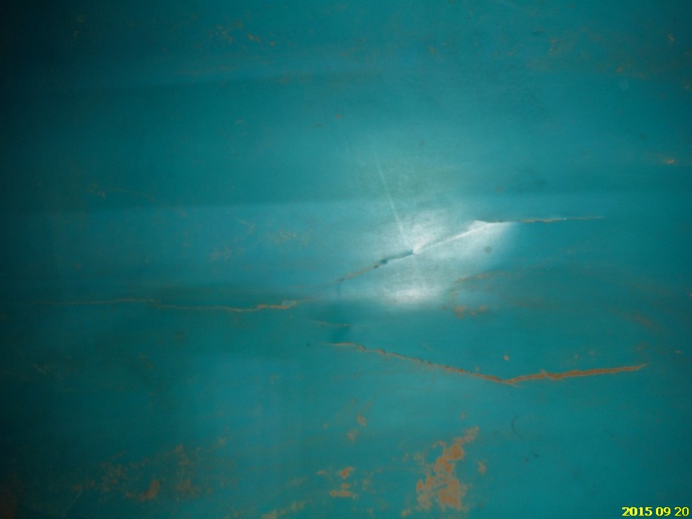

There are three things that probably need attention. Two small delaminations and cracked vinyl/PVC on the inside of the stern along the keel line. I think that maybe it hit a rock after running a ledge but the outside of the hull has no sign of a major impact. The crack is pretty jagged and I'm wondering how brittle the hull is.
This is what I am thinking as far as repairs and I was hoping to get some advice especially if I am about to make a big mistake. Hopefully the pictures are good enough. I have tapped over the entire hull and these are the only issues I can hear.
First, the cracking on the inside of the stern. I can't tell yet if the PVC and the vinyl are cracked or if it is just the vinyl. I guess I should sand through the vinyl and see what the extent of the damage is. PIC below. Assuming that the PVC on the inside of the core is cracked would it be sufficient to widen the crack enough to get any sand/dirt out, fill the voids with something like West Systems G-Flex and then cover the whole area with S or E glass? I'm confused about when S glass is needed, etc. I can't really hear that there is a delamination problem in in the middle of the cracked area from the inside or the outside from tapping on the hull.

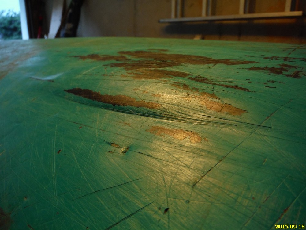

Second, the blister. This area is really soft and it is thin (thinner than I think the PVC layer is?) and as far as I can tell has not opened up yet. There is a pretty major crease along the hull in this area. Are the PVC layers actually made up of multiple thin PVC sheets? I haven't been able to find anything except for a diagram that shows multiple PVC sheets. Anyway, I guess I will cut the raised area off with a sharp chisel. I got a recommendation from the place that sold me the G-Flex to keep it connected on one side, peel it back, sand it, flash it, and glue it back down. I guess after I cut around the "blister" I would sand around the edges outside of the damaged area so that I could feather it back in when I glue it back down. I guess I have to just get to cutting it and see if it is down to the foam or not. I have read some posts that say leave it alone until it breaks open. This, section is under a knee pad. I think it is the original pad so I am hoping that there isn't an issue with too much adhesive...

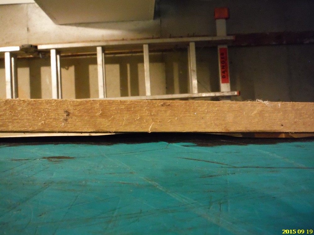

Third, the raised area on the keel line right under the pedestal. I don't know exactly what happened in this area but the PVC is thick and not at all soft. I think that from tapping there might be a hollow area here but I'm not sure. It seems to me that this is the major wear area. The vinyl is long gone but PVC seems to not be warn down much. I guess the question is should I cut it off and patch with S or E glass or just reinforce?
