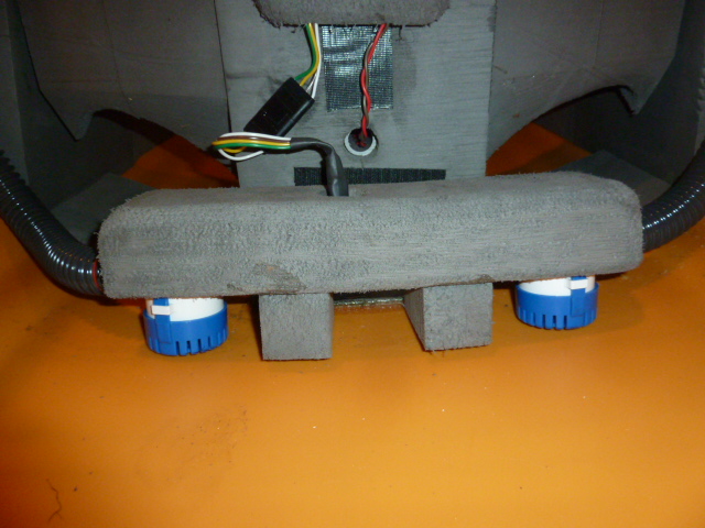

it all velcros to the saddle.
Re: Has anyone built a removable electric pump setup?
http://www.zralok.estranky.cz/fotoalbum ... photo_8212" onclick="window.open(this.href);return false;
http://www.zralok.estranky.cz/fotoalbum ... photo_9159" onclick="window.open(this.href);return false;
http://www.amd-autodily.cz/chladici-sys ... horni.html" onclick="window.open(this.href);return false;
5 canoe , 1 pump
5 canoe , 1 pump
